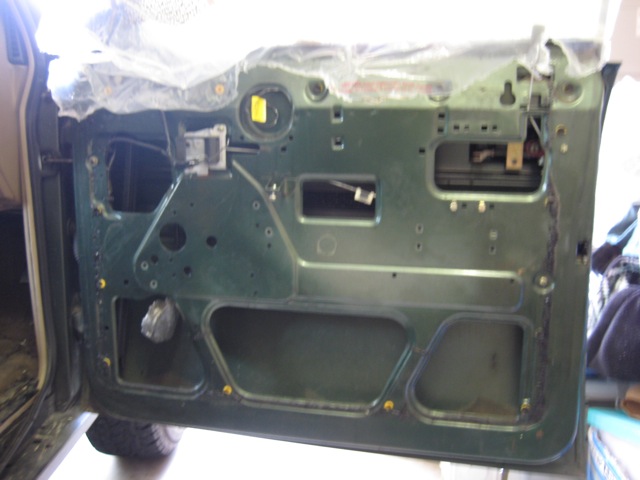

Step two. I removed the interior door panel. (pic 1)

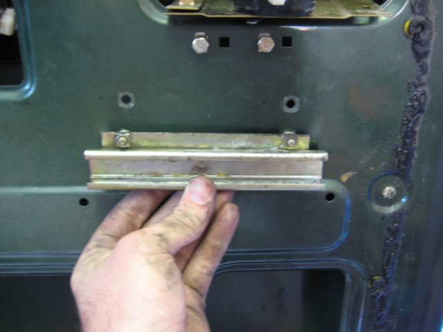

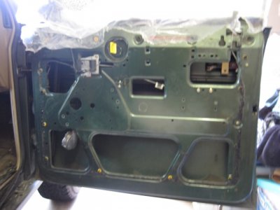

Step four. I noticed that the window regulator was off track. The track that is about six inches and is mounted inside the door about midway. (pic 2)
The picture shows the track removed. Notice the two mounting holes just above the track.
At this point I had re-connected the regulator arm to the track and tested the system by pressing the window switch many times. With every try the arm would fall off of the six inch track when the window was in the full down position. From here I searched and searched the forums with no luck. In-fact the closest thing I could find was that many people ended up replacing the regulator, but mainly due to a different issue.

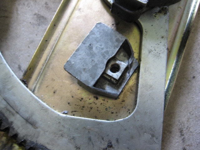

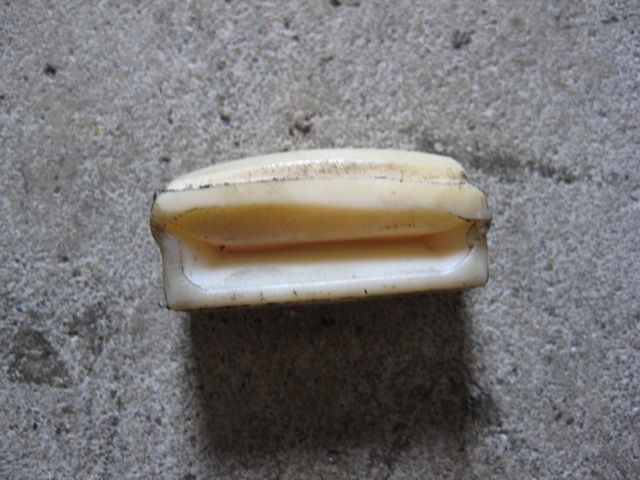

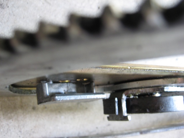

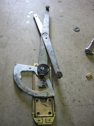

Step five. I decided to remove the regulator to inspect. (pic 3)

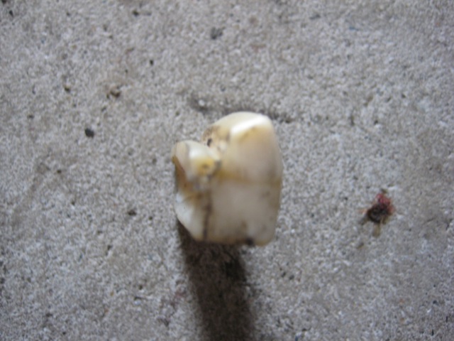

I noticed that there is a two part piece, that I don't know the name of, which acts as a stopper of some sort. It stops the regulator arm when the window has reach its down position. (pic 4) (pic 5)
(pic 6)
The plastic piece was deformed from wear and tear and the metal piece was cracked, which doesn't seem to be an issue, also it was worn where, when window is in full up position. (pic 7) (pic 8)
Step six. I shaved off a bit of the deformed plastic and flipped it over, reinserted into the metal piece and re-assembled the regulator unit. Tried the window operation via the switch several times to find that I have fixed the problem. Sweet.
