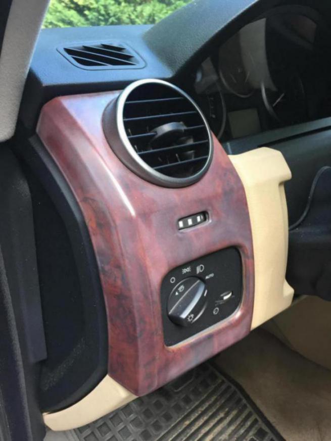

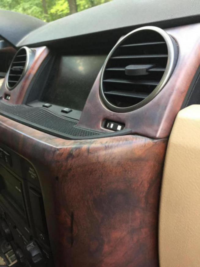

Here are the original factory pieces, which had faded after 10+ years:
  • 69745d1466909929-adding-3d-woodgrain-interior-trim-image_1466909912558.jpg
  • 69761d1466911652-adding-3d-woodgrain-interior-trim-image_1466911636372.jpg

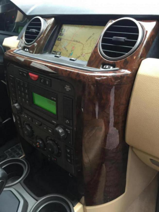

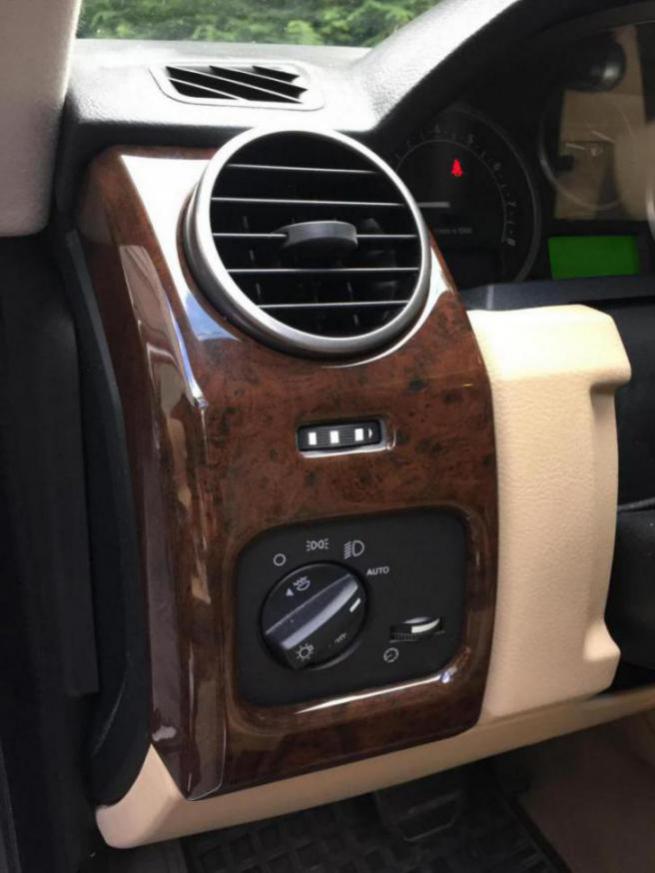

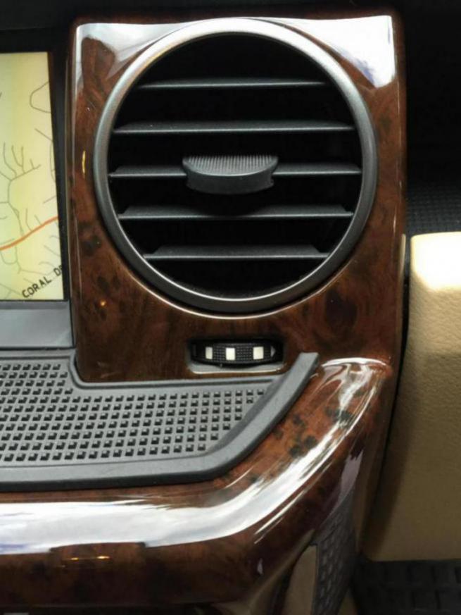

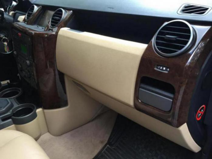

Here is the new woodgrain kit installed:
  • 69753d1466910393-adding-3d-woodgrain-interior-trim-image_1466910377296.jpg
  • 69769d1466911716-adding-3d-woodgrain-interior-trim-image_1466911701040.jpg
  • 69785d1466911858-adding-3d-woodgrain-interior-trim-image_1466911842531.jpg
  • 69793d1466911892-adding-3d-woodgrain-interior-trim-image_1466911874491.jpg

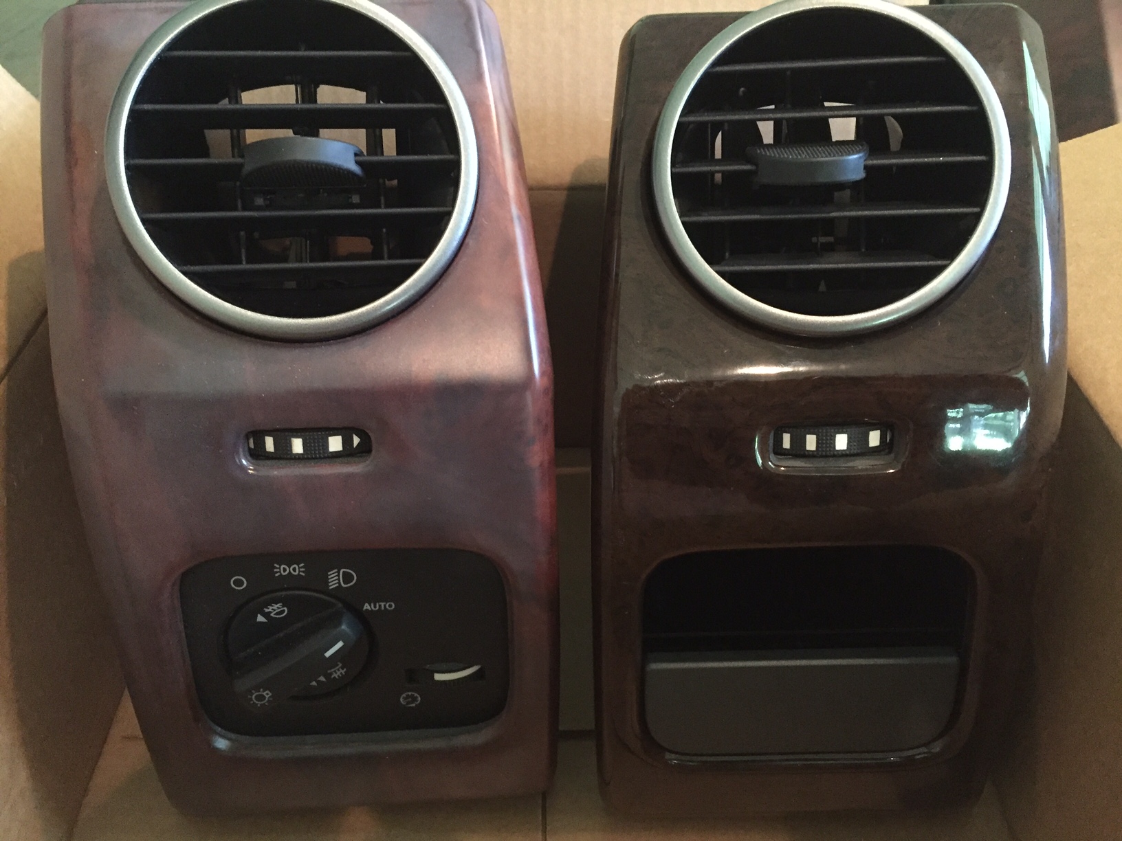

I found a higher-res picture of a new side vent vs. old side vent, here goes:
