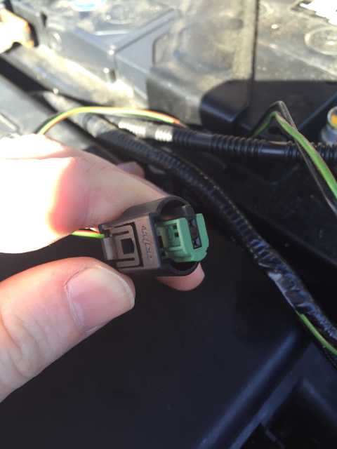

I've been having intermittent problems with my wife's 2011 LR4 being dead when she goes out first thing in the morning to start it up.
I had the battery and alternator tested in the vehicle 3 times. Battery tests fine each time, alternator tested fine twice and finally on the 3rd time it tested as "bad voltage regulator".
I removed the battery and alternator to have each bench tested isolating the components. Battery tested fine again and Autozone couldn't test the alternator.

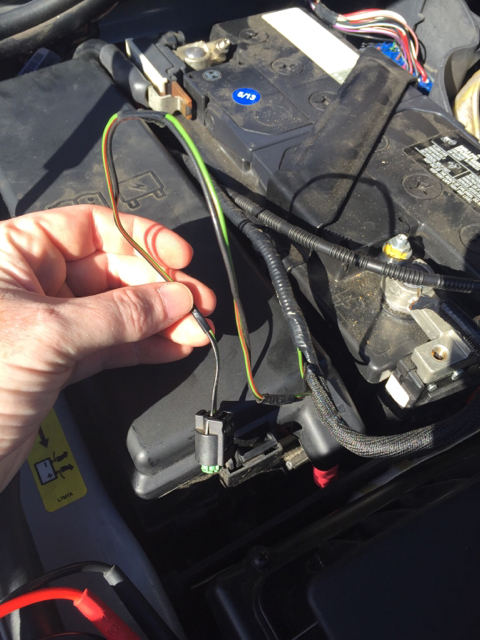

When I pulled the battery out there was a 2 conductor wire, with what appears to be a factory connector on it, tucked under the battery not connected to anything. Wire is green/red stripe and black.
Any thoughts on what this might go to?
Thanks
umbertob
Apr 18, 2006
2,701
432
California, USA
It's the connector for a battery cutoff relay designed to prevent the battery from discharging during transportation of the vehicle to its final destination from the UK, or while the car is sitting unsold on the dealer's lot. The transit relay is unplugged and discarded during PDI. So, the connector doesn't go anywhere after the vehicle is sold and delivered to the customer.
The one on my LR4 is also hanging loose in the battery compartment near the positive terminal, although its contacts are protected by a plastic cap which may very well have fallen off or been forgotten on yours - no big deal because the connector is useless after delivery anyway, with or without blanking cap. Don't worry about it and just leave it alone.
