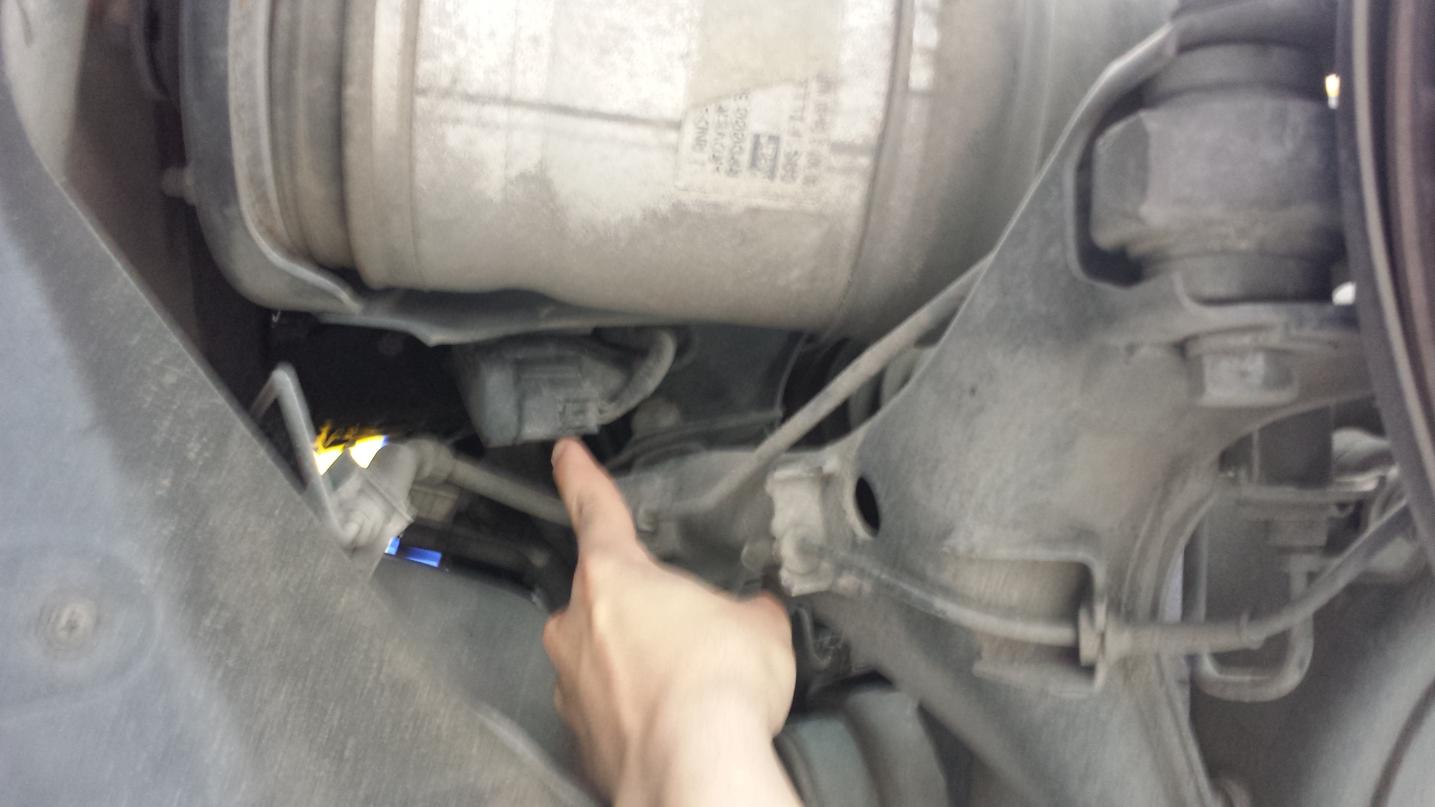

So, I'm back home and coming July I'll be using my LR3 again...
some may remember I've been having suspension issues for AGES!
my 3 currently leaks almost all of the rear air in a matter of an hour or so and as it is apparently IMPOSSIBLE to find an honest mechanic (who can work on Land Rovers) in this city, I've decided to do it myself.
Anyhow, this is the rear air valve block isn't it? (Yes Houm you convinced me not to swap for coils hahahha)

YES , this is a rear valve block. A ***** to replace and put new one back, especially old harness connector did not wanted to click back into a new piece that came with a new valve.
