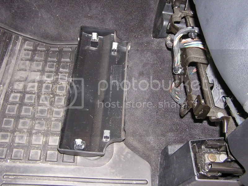

I just updated my DVD and took some pictures for anyone who might need a little help.
Remove front panel, it just snaps off:

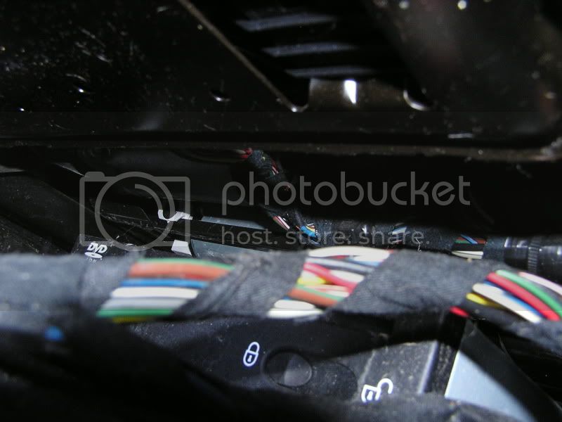

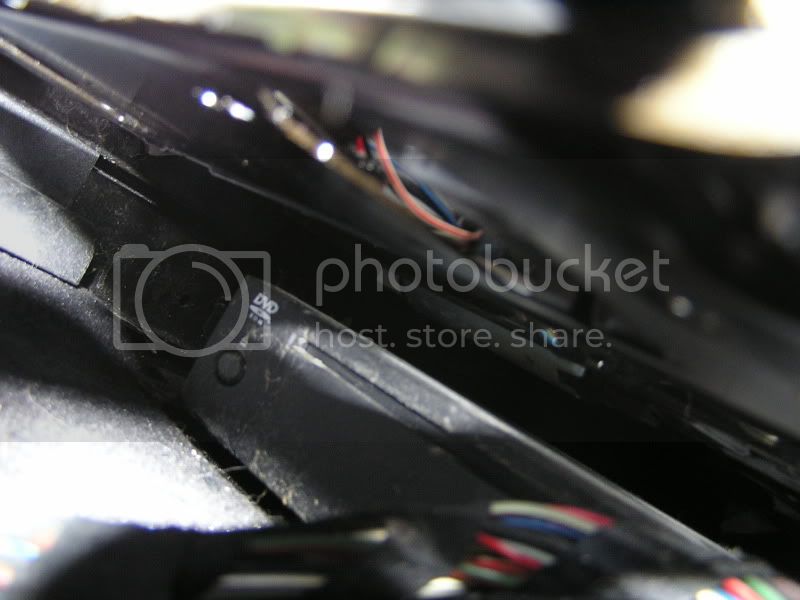

Move the seat all the way forward, and slide the button to "unlock"
hit the eject button and do everything in reverse when you put it back together.
10 minute job.
