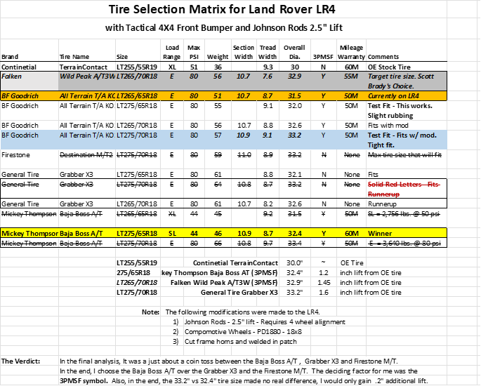

For everyone's edification, I have attached my Tire Selection Matrix which I created to aid in my tire selection. My primary consideration for getting the tire I wanted was the Three Peak Mountain Snowflake rating.
Now a "shout out" to the good guys at the America's Tire Store in Huntington Beach, CA. They allowed me to test fit a number the tires without any fuss. A word to the wise, test fit your tires first, BEFORE you buy them.
